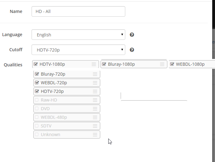

I have been playing around with this for a couple of months but I still can’t get it to work to my satisfaction.
The problem with this is, sometimes the 1080p webdl shows up, sometimes the 1080p hdtv. And I cant put them both “on top” :stuck_out_tongue:
Problem:
What if I dont care about source? (webdl, hdtv).
I want to treat all 1080p equally, and call anything that’s 1080p “best possible”.
This is what I want to achieve:
If I choose all 720p and all 1080p and then sets an 8 hr delay to hopefully get something better than a 720p, but I want to start the dl as soon as any 1080p shows up, how do I do that?
I guess what I am missing is 2 more qualities just named “720p” and “1080p” not caring about source.
Or even better, the ability in the quality-profile to treat profiles equally.
See my awesome mspaintskills:
Edit: Or well, it would be better to be able to still rank them.
What I guess I really need is a “Cutoff” for the delay-profile!
You don’t have to have then on the same level. Just have the other qualities above your cutt-off quality.
Blu 1080
web 1080
hdtv 1080
blu 720
web 720
hdtv 720
Cut-off set to hdtv 1080 as it’s the lowest 1080p source
Delay set to 8 hours.
If either blu / web / hdtv 1080 is found in the 8 hour period that will be downloaded.
If neither blu / web / hdtv 1080 is found in the 8 hour period the found 720p source will be downloaded. After that, Sonarr will continue to monitor for any 1080 release.
If you set the cut-off to the lowest 720p, it will never upgrade after the 8 hour period.
