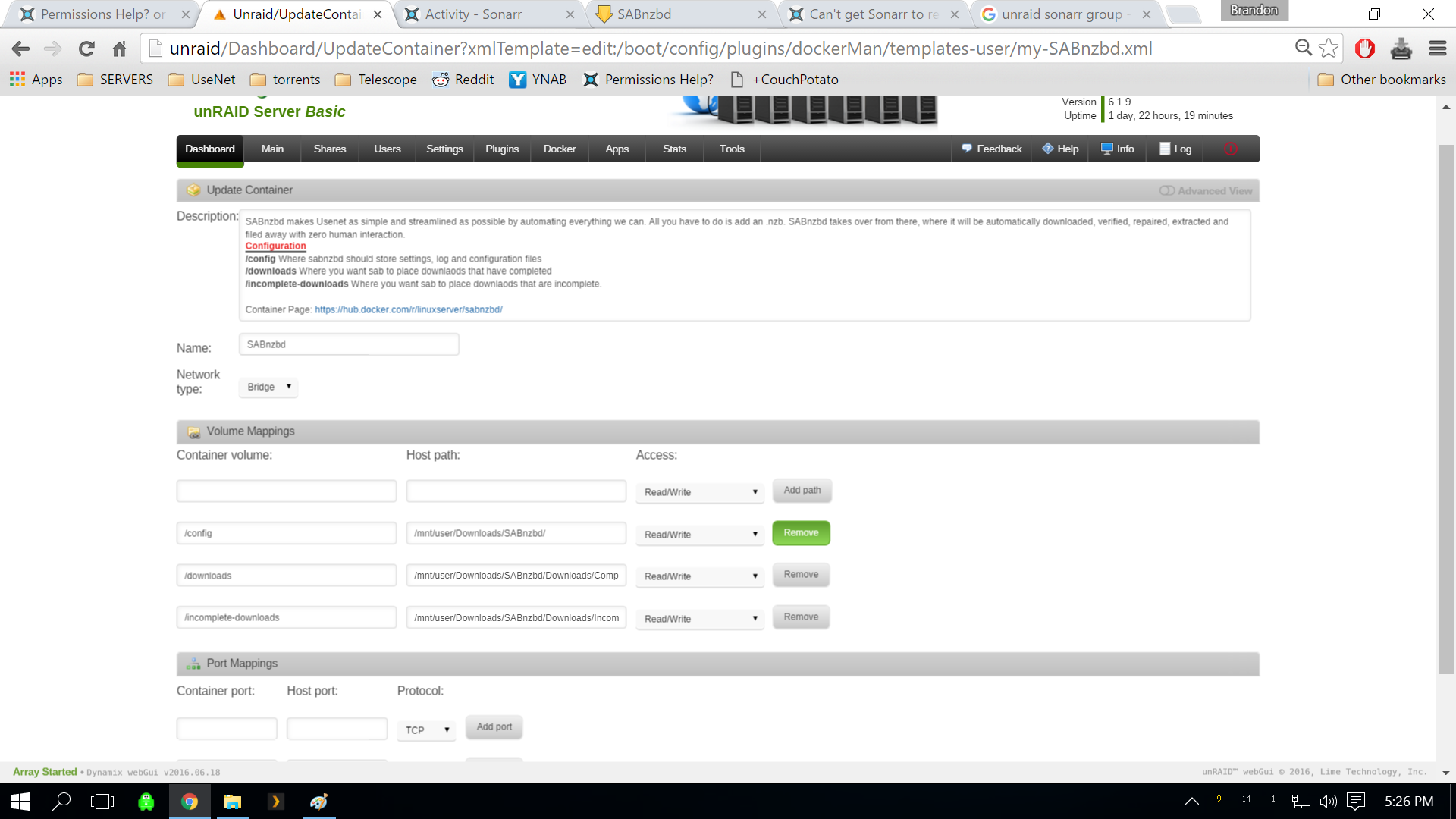

Apologies, first ever install of anything other than Windows. I did much googling, and cant find how to tell which user or group my docker is assigned to. under sonarrs docker>edit PUID 99, PGID 100 on both SAB and Sonarr??
I may be wrong, but im accessing the server from my windows machine. i navigate to my share (downloads)… navigate to the file Downloads/SABnzbd/Downloads/Complete/sonarr The downloaded folder and file only had read permission. i edit and gave both read/write access to test. no change.
You are correct, i was testing with folders. Yes, SAB and Sonarr are in dockers, however each have been install in their own sub folder. Should i change this? How can i confirm they can access /config/Downloads/Complete/ ?
Sonarr docker
SAB docker
Im new to anything but windows, thank you for this help!
I think your SAB folder is wrong, it should be pointed at /downloads, not /config.
/config/Downloads/Complete/sonarr/Fear the Walking Dead S02E07 720p HDTV x264-FLEET-BUYMORE/ Which should translate to /downloads/sonarr (based on what I can see about your paths) and should work because it looks like SAB and Sonarr both have read and write access to that location.
