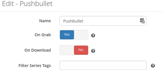

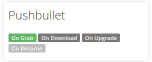

I’m running Sonarr version 2.0.0.4653 in Docker (linuxserver). I temporarily turned on download notifications in Pushbullet while I was tweaking out SAB. Now I don’t want to receive them but I’m continuing to get download messages with the toggle off. On Download is also lit up dark gray on the Pushbullet Connection that is added. I also tried deleting the connection and re-adding it with no new result.

No. I’ve enabled On Download, disabled everything under it, and then disabled On Download. I’ve also disabled and re-enabled On Grab, as well as deleting the connection entirely and re-adding it. It’s weird, On Grab is highlighted green but it’s not notifying for it. Only completed downloads are notifying, which I don’t really want any longer.

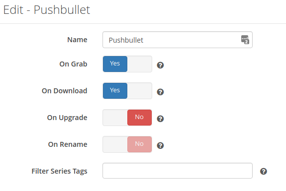

If I turn On Download on, here are my settings underneath it:
The only instance of a PushBullet message being sent is after the grab (after the NZB is sent to SABnzbd), I don’t see anything during the import:
