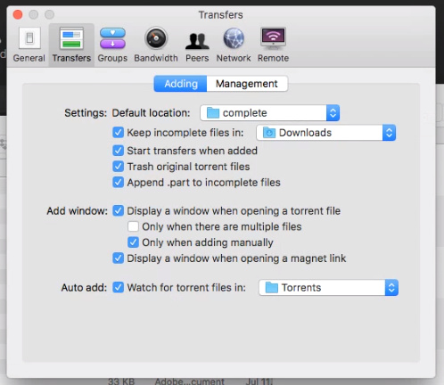

Okay, so the only way I could get it to work was if I set the (in Transmission app) default folder to “same as torrent”. Why would that be? This will cause issues now for any other torrents I want to download outside of Sonnar. For example, I have an automation where Transmission picks up torrent files from a dropbox folder. Setting it to “same as torrent” will try to download the files directly to dropbox, which I don’t want to do.
You shouldn’t have to change that setting, it should just stay in the default download folder unless you set Directory in Sonarr’s Transmission settings and in that case use Category instead.
Nope, if I set the folder to just /downloads as “default download folder” in Transmission, Sonnar completely ignores it when the download is complete. It has to be “same as torrent file” otherwise it won’t work.

Also, adding a category in the settings such as “TVShows” just creates a sub folder in downloads and still doesn’t process the files.
