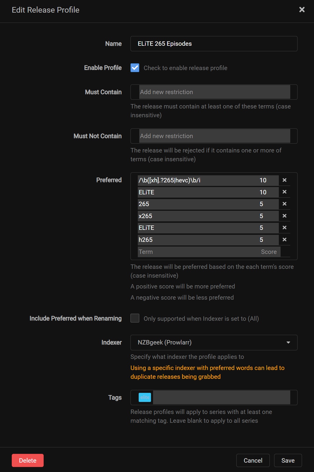

I’ve tried to set Sonarr up to DL certain TV episodes in a 1080, 265 format, but, it seems to just download it in 1080, 264. Is there a way to sort that? (I think it may be down to not fullty working with NZBGeek, and so it’s grabbing the closest thing, from RARBG instead, but, I may be wrong).

I haven’t, that’s my issue. I mean, I know it can be done, but, I’m struggling to get it right, as it just grabs a full 1080, 264 version of the episode, which is always a big sized file. I’ve tried to set up a release profile to get the 265 episodes, but it keeps bypassing it. Obviously I haven’t set it up right though, so looking for someone that can help. Cheers.
By adding a release profile, in the settings-profiles section. I added all the keywords, and tags, that I thought would make Sonarr get the 265 version of the episode, but, it just grabbed a 1080, 264 version instead.

Yah, I thought as much. Also, I checked this morning, and it’s still grabbing 1080 264 files, instead of 265 lol. So, I went through the setup steps, with the show BMF as an example.
Step 1: Setup a profile to grab MeGusta episodes from NZBGeek (with MeGusta tag):
Just tried that. Same result. I even tried excluding x264, H264, with must contain as MeGusta, 265 etc, and all manner of combinations, but yeah, it’s still grabbing the 1080 264’s right away. I tried removing Prowlarr, and using NZBGeek as the indexer, directly from Sonarr, but now it doesn’t pick anything up.

Must contain in a single release profile must contain at least of of those terms, if you want multiple to be required use multiple release profiles. Make sure you’re setting the same tag on each series, beyond that you’re going to need to look at debug or trace logs, it’s impossible to say why Sonarr grabbed a release without those.
