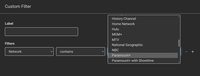

Netflix not listed in NETWORK list under Custom Filters
Mono version (if Sonarr is not running on Windows): 4.0.16.2944-ls297 by [linuxserver.io]
OS: Docker
Description of issue: Would like to filter all shows from Netflix, however Netflix is not in the list of Networks under “Network” tag in “Custom Filters”. Can Netflix be added by devs or manually by me?

The list of networks is based on the networks for series you have, it’s not a complete list of all networks in existence (otherwise that list would be gigantic). If you’re not series Netflix it’s because there isn’t a series with that network currently in your Sonarr instance.

Well how about that. You are 1000% correct.
Thought I had some shows in the list, must have removed them as watch them on Netflix directly.
