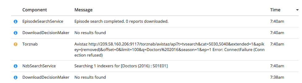

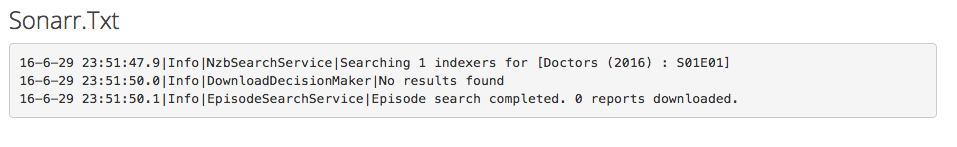

Here are the screenshots. Is there a way a i search/add my files directly from my indexer database and the rest of informations from TVDB or is there any work around for me to solve my problem or ? Please advice and thanks again

Your logs (the table) show the request wasn’t even responded to by Jackett. You’ll need to fix what ever is causing that to fail.
Like I said, the name is an issue and will forever be an issue because the series name their using (Doctors) conflicts with releases for the series that actually has that name: http://thetvdb.com/?tab=series&id=83729&lid=7
