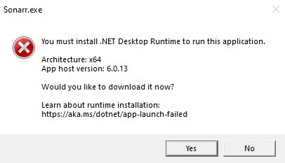

Immediately after the vers upgrade, upon reboot Sonarr fails to start and error prompt appears: ‘You must install .Net Desktop Runtime to run this app.’
Architecture:x64 & App host vers: 6.0.13, ‘Would you like to download now?’. Click Yes, does nothing.

Can you post a screenshot of the error you’re getting?
sonarr -must install .net runtime msg
Here you go. I get the same thing every time. Clicking Yes to install does nothing.
