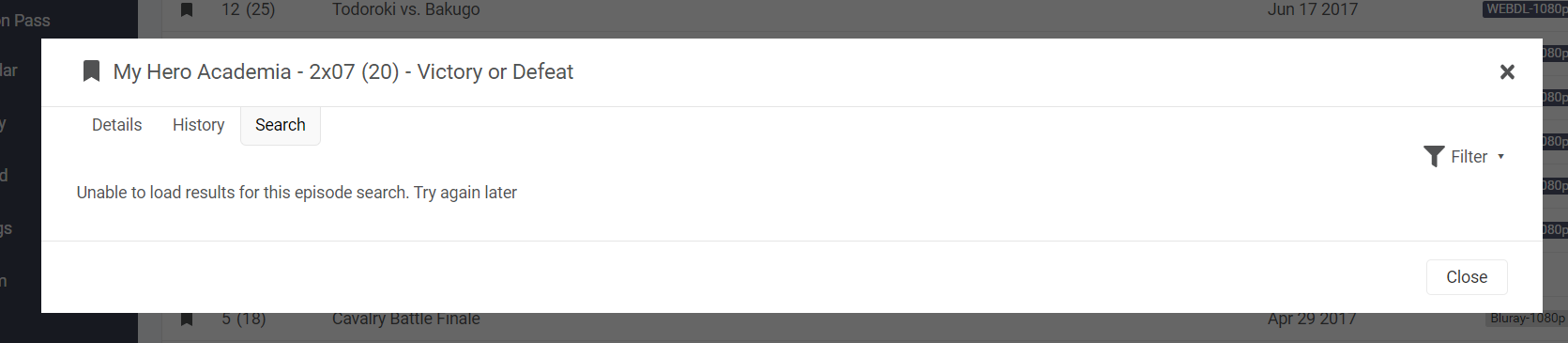

Sonarr version (exact version): 3.0.4.1060, using docker Mono version (if Sonarr is not running on Windows): 5.18.0.240
OS: Debian GNU/Linux 10 (buster) Debug logs: hastebin - iyefohesod Description of issue: When doing manual / interactive search for some episodes, receive message: “Unable to load results for this episode search. Try again later”
I believe this is due to the queried results list being too large perhaps? I grabbed debug log immediately after the message showed, but it’s not reflected at the end of my log – only the searches are. The trace log, which I have, does show the list being parsed, but for some reason it never gets showed to me.

If the search finished and was processed by Sonarr that means it did not cause the UI to timeout, that almost certainly happened due to a reverse proxy terminating the connection before Sonarr completed the request.
How can I check if this was the case for sure? I have other items I found I can’t interactive query. Is there a setting within Sonarr I can adjust to help with this?
Looking again at end of trace logs (let me know if I could hastebin and show you), there is no evidence of anything different from the other download queries. HttpGet, Config for using default for ‘proxyenabled’ which is ‘False’. Then, instead of showing things being Parsed, there is nothing until me requesting my trace logs.
The fact that you see results being processed, but don’t see them in the UI is a good sign something else is timing out the connection, unless of course you see an error, but there doesn’t appear to be one in the logs.
No, nothing in Sonarr’s API or UI will timeout these requests.
Are you using a reverse proxy to access Sonarr?
How quickly do you see the error in the UI?
Best thing to do at this point:
Clear log files
Perform interactive search
Wait 5 minutes (even if you get an error in the UI)
