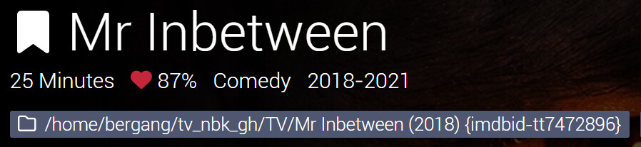

Here you can see how when I added the series to Sonarr and told it what root folder the series will use, it added the series name to give it a unique path which I have configured to include the year for the series and the IMDB ID in the folder name to assist my media server software in identifying it.
The reason I wanted you to hit Interactive Import was if you get the dialog box like I did for the episode import it means that the issue is most likely not with the Download Client configuration and more likely to be with the Root Folder configuration. Give it a try and make sure as a minum that the series, season, and episode are configured in the dialog box. If they are you should be able to hit Import.
