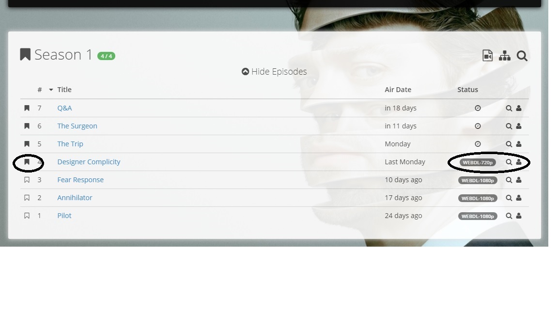

not if the monitored flag has been turned off
if its hollow, like the one circled red in the image above, it wont keep looking, if its solid then it will
It is solid. I was confused because it dropped off of the “wanted” list.

  1. The episode currently with a 720p version downloaded and the box blacked out to show it is to be monitored.

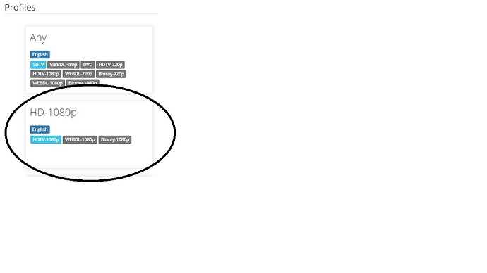

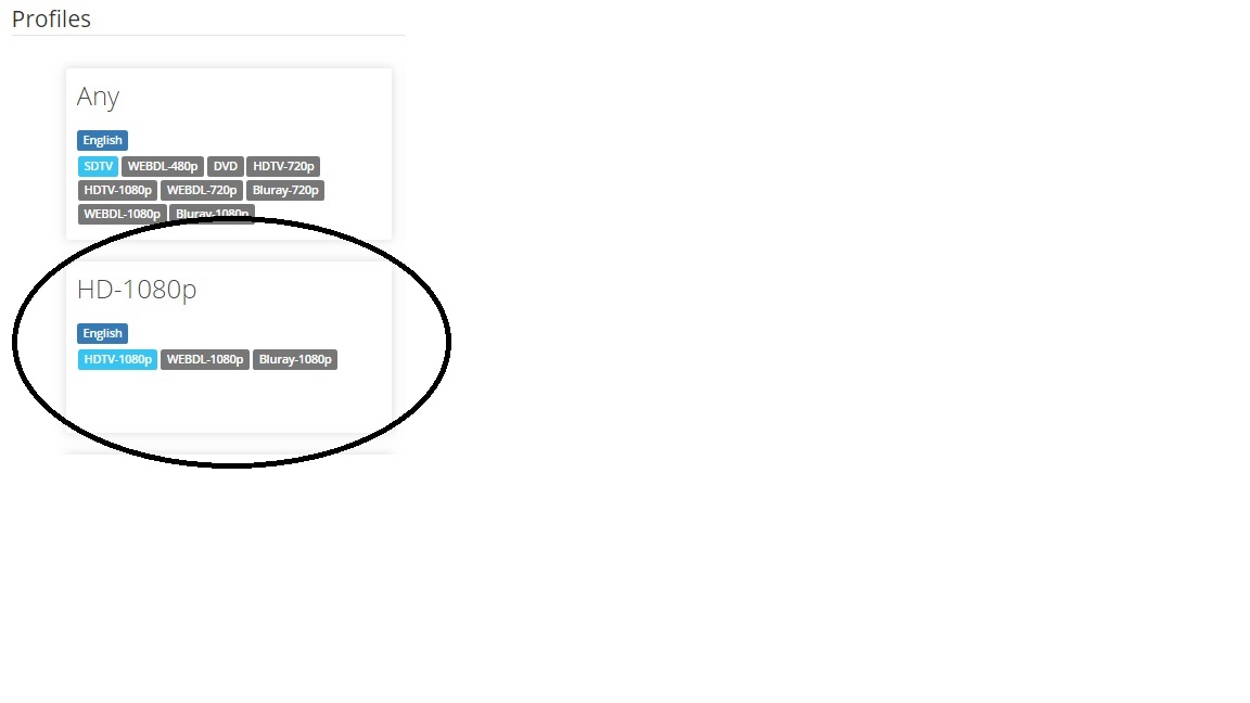

  2. the setup for the show indicating the profile is HD-1080p
  3. the HD-1080p profile

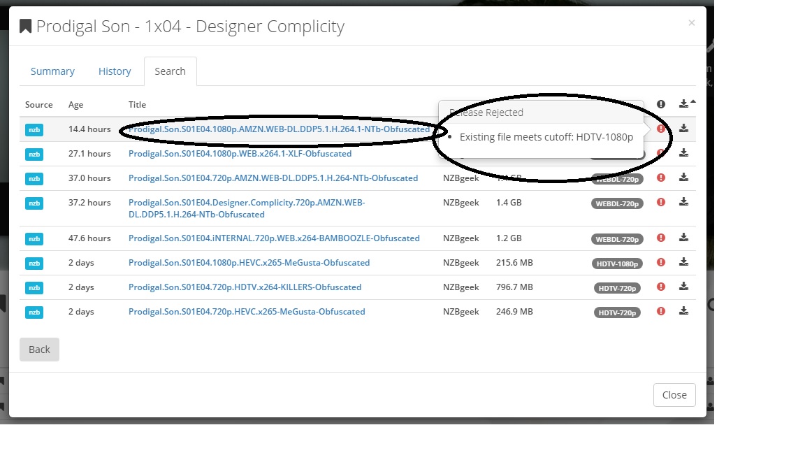

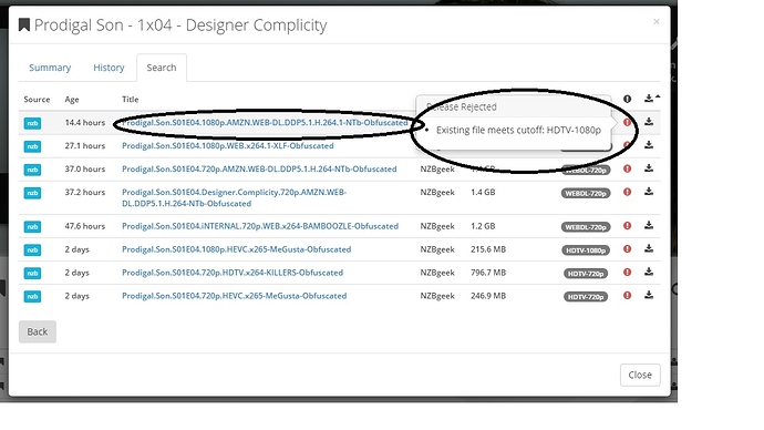

  4. a manual search of the episode that shows that the episode is now available but a note in the status that says “existing file already meets cutoff”.

And further, the message in the fourth image doesn’t say “I don’t know what 720p is so I guess you’re on your own.” is says the existing file meets or exceeds the cutoff.
That being said I did look at the details in the profile and noticed that webdl-720p is listed above hdtv-1080p (but it is below webdl1080p, which is what I want). I’ve reordered the 720p to be below the 1080p options but still left it unchecked because I don’t want Sonarr to pull those.
Are you saying that I have to select 720p in my 1080p profile so that Sonarr will “know” that 720p is lower than what I want?
720p is just a text string. Sonarr doesn’t know what you prefer until it is given a list which tells it. When it’s unchecked it probably doesn’t include it in the known order list. Wouldn’t it be easier to try to enable it instead of discussing it here for so long?
I’m not sure how to read the screenshot of your profiles in v2 anymore, this would have been easier with a screenshot of the details of the profile when you click on it, but from skimming the thread:
Hdtv-1080p is the cutoff.
You put 720p above hdtv-1080p, telling sonarr it is better than hdtv-1080p.
You downloaded a 720p file.
So sonarr is doing what you told it to do.
Selecting/deselecting the quality in the profile is not applicable in the sense that it doesn’t mean “I want this quality” when you manually import a file you got from somewhere else. Sonarr will import it, check the quality, see it’s 720p which you told it is “better” than your cutoff quality… So sonarr’s work is done. It has a file which meets or exceeds your cutoff.
