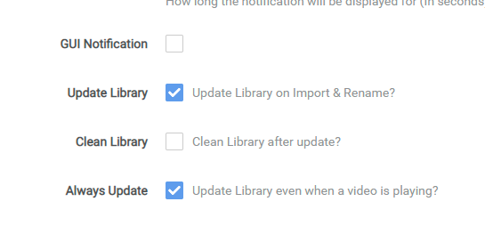

As a quick update I think it is something to do with this setting seeming to do something strange
I have been messing around with it tonight and managed to get it working. It then stopped but unselected the update library and then saving, then reselecting and saving seems to work. Will monitor it over the next few days.
