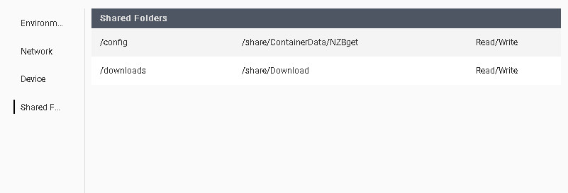

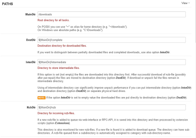

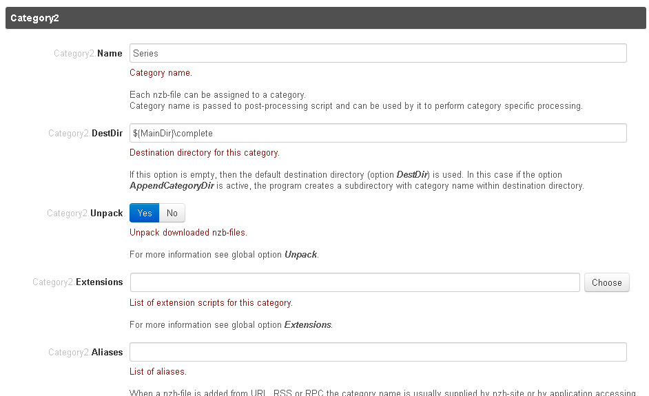

Sonarr works fine with NZBget and the files get downloaded to the /share/downloads/complete folder
If I understand it correctly, Sonarr would now take over again and rename the file (currently its often “9s87hr94sidufhw94shu” and place it in the folder for TVshows “3”, correct?

The second message I don’t get. The path is accessible when I try via via the Docker CLI. I can e.g. remove a folder from completed
