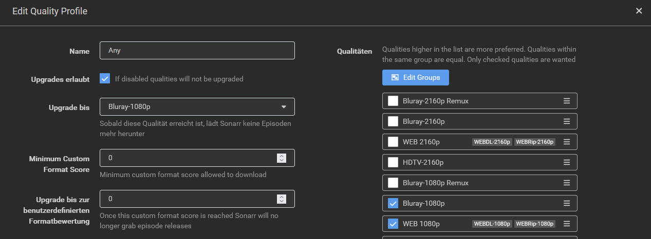

Here is however the screenshots from the Quality Profiles I use.
The “cutoff” for your Custom Formats is 0, so as soon as anything is grabbed that will be met and you’d only get an upgrade in quality until Bluray 1080 is reached.
Yeah that’s the issue I’m describing and the unexpected behaviour. Why aren’t the custom formats taken into account for a language upgrade when I have an English only locally but there are German and German+English available which would boost the score?
With your profile the cutoff for any CF upgrade is already met, if you want to upgrade to a high scored release you need to raise the cutoff for CFs above 0.
