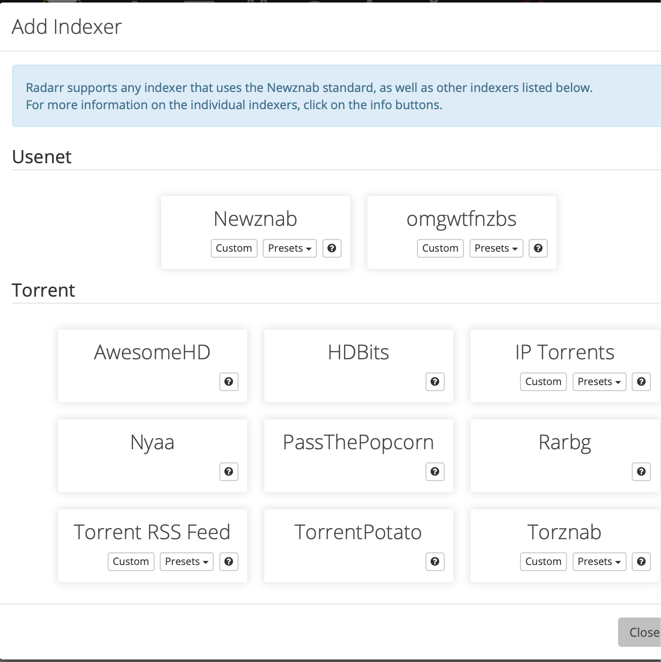

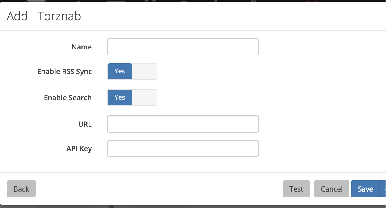

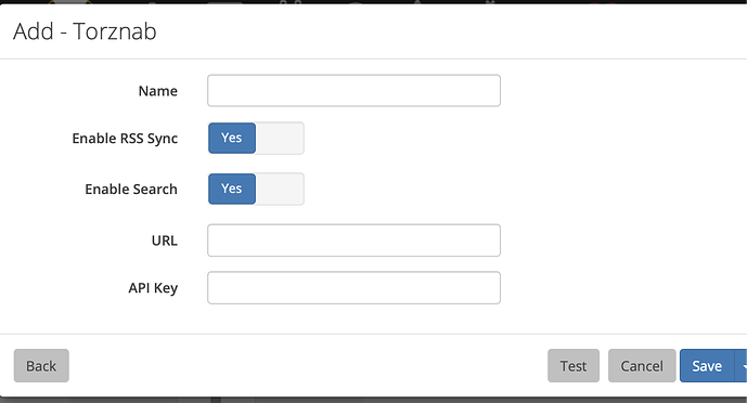

there were no fields for categories in the radarr setup. url, api key were it (and name). toggles for rss and search.
you may have used the wrong indexer type, or you may have an old version of radarr? i have version 0.2.0.1480 (linuxserver docker image)
my torznab (what you use for jackett) based indexer options look like this (currently disabled as i dont use this one at the moment)
Radarr Ver. 02.0.1480

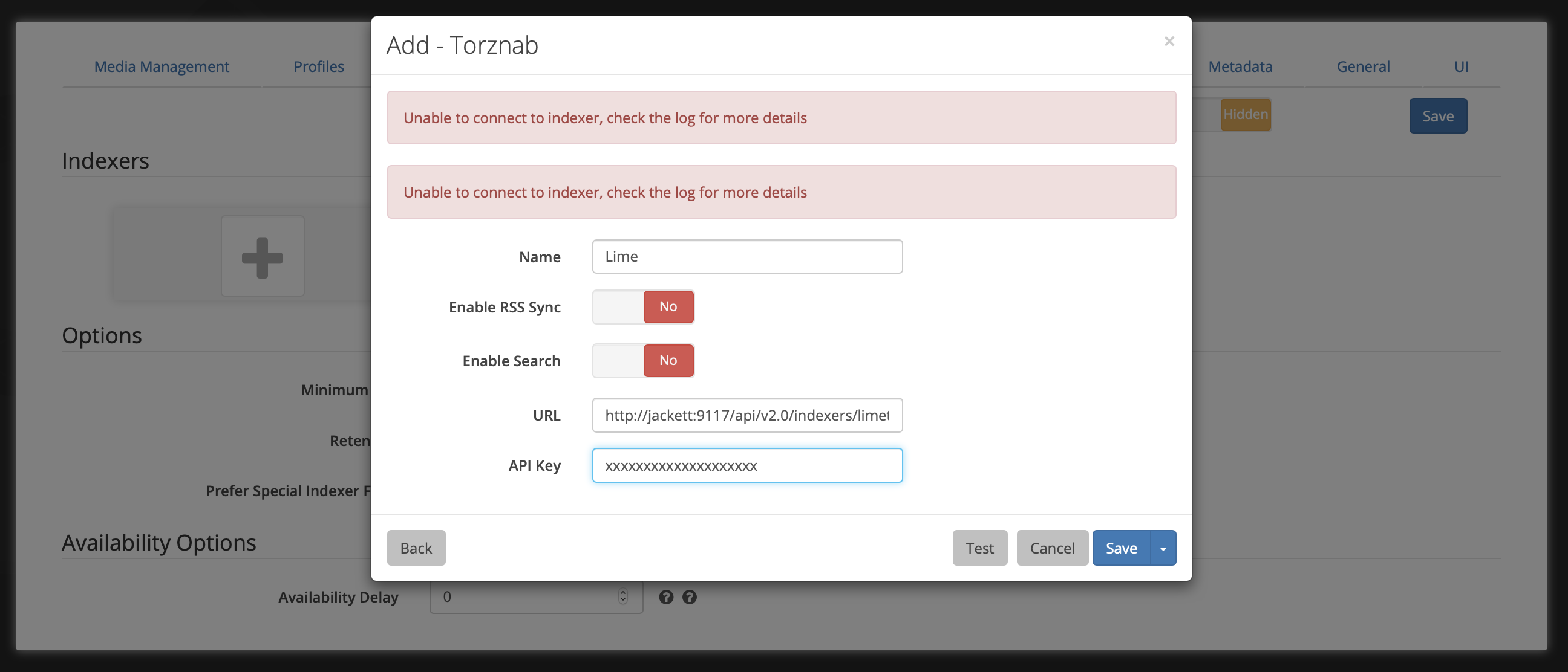

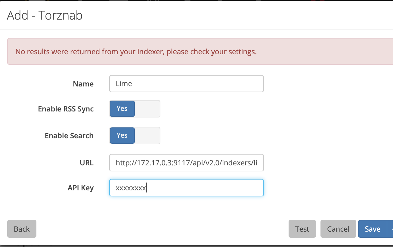

Embarrassing … been here for an hour not able to add a single additional index to even Sonarr.
Same method.
  • Select a source from Jacket. Source test passes. Search test passes.
  • In Sonarr, add the url (change the local host to the 172 jacket ip,) add the key and add a few category numbers listed in the source specs page; anime left blank. Also used same categories as from last night’s success.
  • All results are the same “No results were returned from your indexer, please check your settings.”
NzbDroneErrorPipeline Invalid request Validation failed:
– No results were returned from your indexer, please check your settings.
FetchAndParseRssService No available indexers. check your configuration.

Add - Torznab still not showing option for categories.

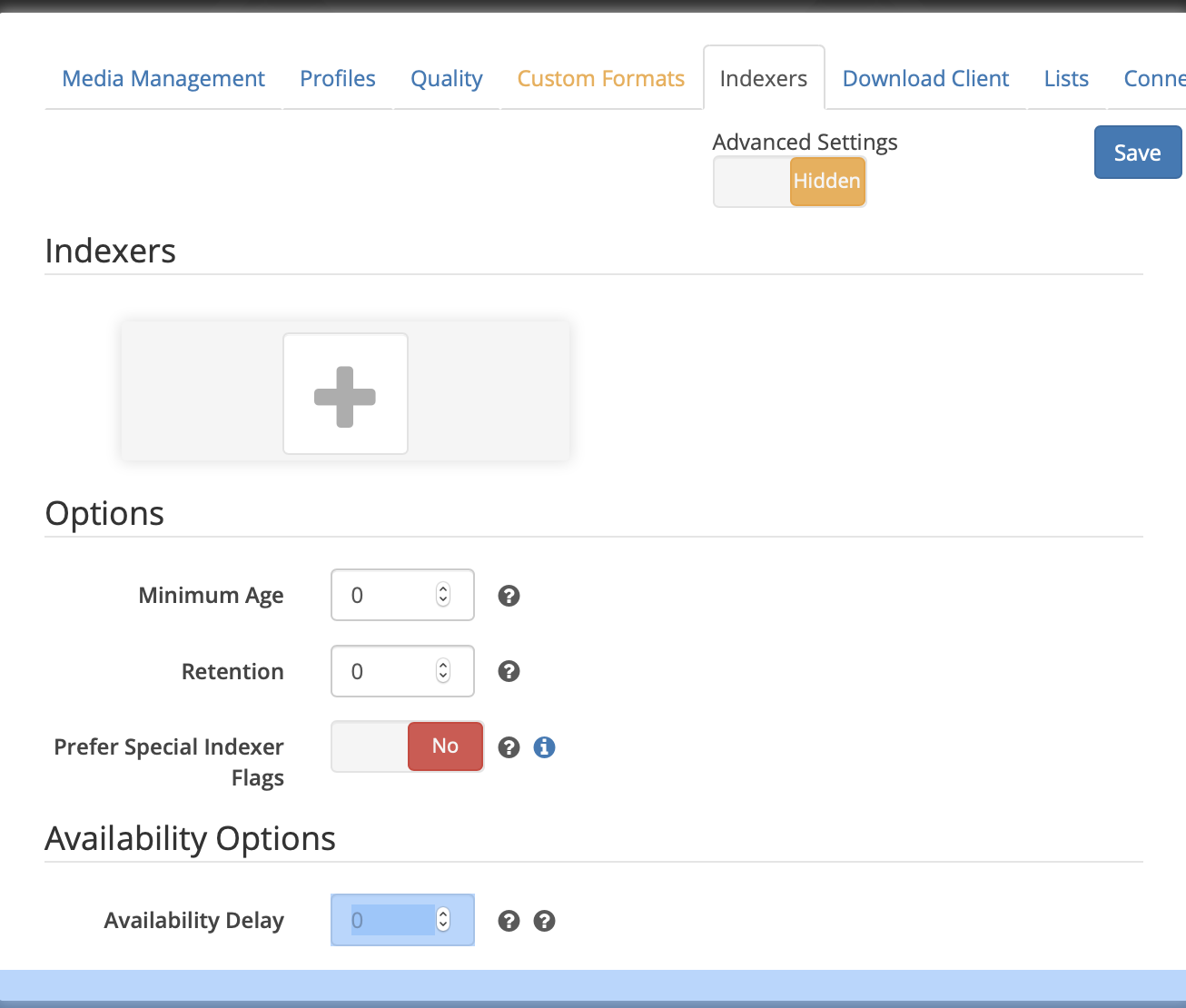

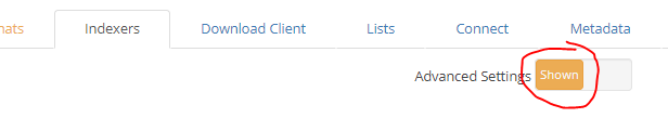

for radarr - on the indexers page, tun on advanced settings
then add your indexer and you should see the extra options

Ah,saw the advanced and didn’t realize that also changed options for the add panels.
Alas, same result. This example uses the exact same settings as the working Sonar index for Lime

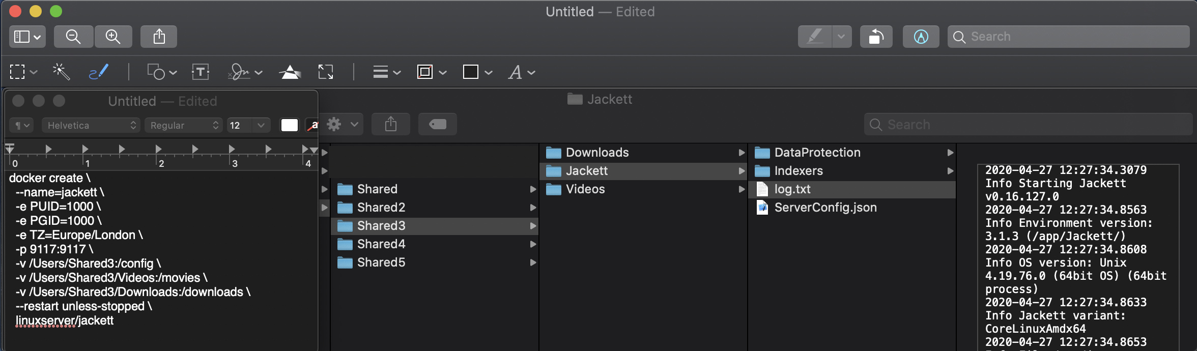

Finding something different here and wondering if this might a problem?
Sonarr and Radarr have relatively similar directory structures. From the post stating the log would be with the config file, presuming the same might be true for Jackett.
While Jackett appears to be up and running just fine, the directory structure appears different.
Here is an image of the setup config file and its respective directory structure.
Is Jackett meant to be in it’s own directory like that, or possibly the target Downloads and Video files are meant to be together, and at the higher level?
Experimented adjusting the directory to bring DataProtection, Indexers, log.txt and ServerConfig.json up a level to see what might happen. Restarting docker, and having to restart Jackett, Docker created the Jackett directory again. Strangely enough, no impact to the data everything was still there. Anyway, restored the original directory. Experiment failed.

Turns out, the IP used for Jackett changed AGAIN … to a new unused number this time. So, with the NEW IP the indexes are getting added and I went back and edited the previous indexes w/the updated IPs. They tested and saved, though not seeing a different in performance or anything.

if the tracker doesnt validate i dont think sonarr will add it. if you want to add a (currently) non working tracker you need to turn off RSS and the two search options for it, then it will save.
at some point you have to fix whatever is stopping it from working so you can enable it in sonarr though.
because docker assigns them on container start (its sort of like, or possibly is, DHCP)
its supposed to work with the container name though (like DNS) so http://jacket:9117 should work from the sonarr container but for you it doesnt (which sort of means your docker may need to be reconfigured in in some way - mine worked out of the box but im on a synology nas not a mac)
Sonarr will not add non-working indexes. What happens is the jacket IP changed…so it requires going back and updating the indexes in Sonarr w/the new IP
If the Jackett ip keeps changing (can’t get http://jacket:9117 working) ~ well, no real point in having Plex or any of these things running. Will investigate.
localhost:9117 works from the desktop browser… maybe if not permissions, some customer change needed for urls inside the container?
