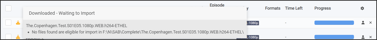

2026-01-04 13:14:23.0|Error|DownloadedEpisodesImportService|Import failed, path does not exist or is not accessible by Sonarr: F:\N\SAB\Complete\The.Copenhagen.Test.S01E05.1080p.WEB.h264-ETHEL. Ensure the path exists and the user running Sonarr has the correct permissions to access this file/folder
2026-01-04 13:14:23.0|Error|DownloadedEpisodesImportService|Import failed, path does not exist or is not accessible by Sonarr: F:\N\SAB\Complete\Down.Cemetery.Road.S01E03.2025.1080p.ATVP.WEB-DL.H.264.DDP.5.1.Atmos-FROGWeb. Ensure the path exists and the user running Sonarr has the correct permissions to access this file/folder
2026-01-04 13:14:23.0|Error|DownloadedEpisodesImportService|Import failed, path does not exist or is not accessible by Sonarr: F:\N\SAB\Complete\The.Copenhagen.Test.S01E02.1080p.AV1.10bit-MeGusta. Ensure the path exists and the user running Sonarr has the correct permissions to access this file/folder

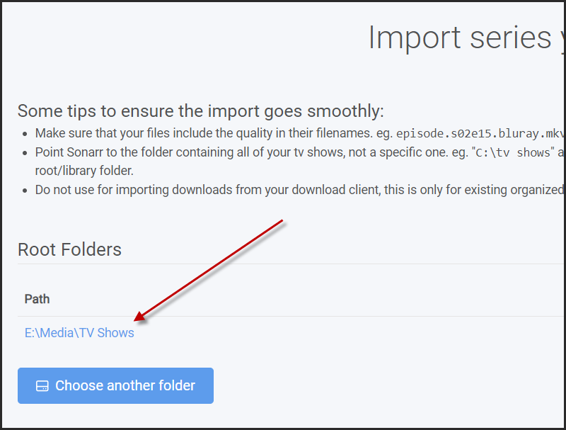

After performing a “Library Import”, I see Sonarr attempting to import files from the download client directory. The files shown in the log above are already within the Sonarr directory structure. Why is it doing this? Later in the day, Sonarr inexplicably deletes all the files that were added via “Library Import”.
What path did you use as the Root Folder in Sonarr that you did the Library Import from?
If Sonarr sees completed downloads that it hasn’t imported from your client before then it will import them. Using a different category for files downloaded before Sonarr is the best way to avoid this if you don’t want it to import files.
Sonarr will delete existing files before importing new ones, the logs only show failed attempts to import that wouldn’t have lead to files being deleted, but if your Root Folder and completed downloads are pointed at the same folder you’re likely to have issues.

I first copied the episodes of interest into the folder structure shown below, then clicked on the link itself to start the import process.

From the Activity Queue:

To Sonarr those downloads have not been imported and it’s trying to do that. Your best solution to clean those up is to remove them from SAB or use a different category.
It sounds like there are two different issues here, one is old downloads that need to get cleaned up, the other I’m not sure, it doesn’t make a lot of sense from what was explained so far (files were deleted, but there weren’t files to begin with and now there are garbage files there), without debug (preferably trace logs) it’s all pretty much guess work what’s going on.
