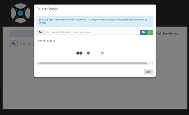

Anyone else having a problem where the dots just keep going back and forth and the recent folders list doesn’t come up?
Other times they come up very quickly with no issue.
Any errors in the logs? I suspect something is causing it to fail, which should be logged.
This is the only error I see in my log in the last few hours.
Error communicating with server: The request timed out
System.Net.WebException: The request timed out
at System.Net.HttpWebRequest.EndGetResponse (IAsyncResult asyncResult) [0x00000] in <filename unknown>:0
at System.Net.HttpWebRequest.GetResponse () [0x00000] in <filename unknown>:0
at RestSharp.Http.GetRawResponse (System.Net.HttpWebRequest request) [0x00000] in <filename unknown>:0
Balls have been bouncing for 3 hours now, no new errors in logs.
The error would happen right away, if it takes more than a minute or two its not going to load and there should be an error, clear your log files and try opening it again.
Change the logging to debug logging and we can get more details to see why it might have failed.

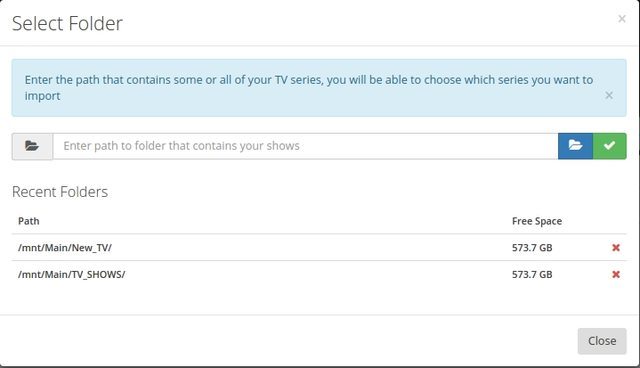

Here’s what it looks like when it works properly. Just two folders configured and they’re always connected.
If there’s a 3rd folder causing trouble, I need to figure out a way to remove it.
