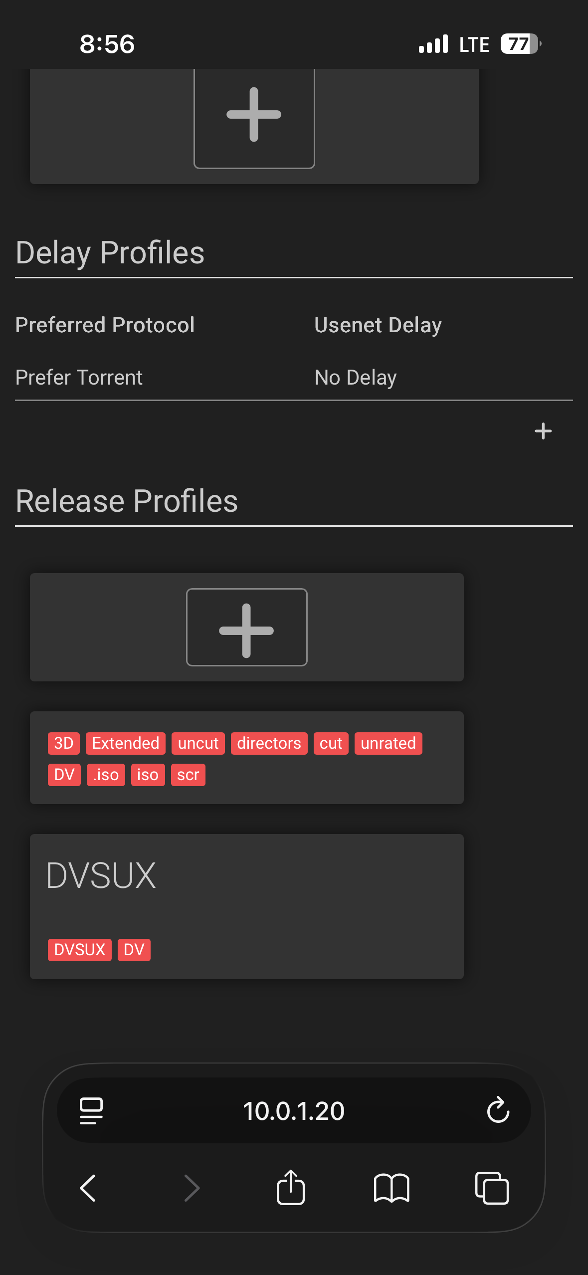

Description of issue: I have added iso and .iso to “Must Not Contain” in the Profiles section but Sonarr still grabs iso files.

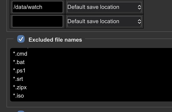

If your download client has a blacklist, add *.iso to that. That’s the only way to prevent the files being downloaded (Sonarr can’t see the filenames until the files are downloaded). It doesn’t stop Sonarr trying (and failing) to import them, but you can install Cleanuparr and set it up to automatically remove the failed imports from the queue.

It probably depends which download client you use - the blacklist works fine for me with qBittorrent, whether or not the files are in a folder.

I use qbittorrent as well but get probably a dozen iso files every week that I’ll have to blacklist and start a new search in Sonarr. You can see in the screenshot above that *.iso is set in the excluded window.

I ended up adding cleanuparr since I am using a seedbox with an older version of qbittorrent that doesn’t have blacklisting. This won’t stop it from downloading initially, but it will eventually remove and blacklist it when the import fails.
Must Not Contain applies to the release name, if the release name doesn’t contain .iso then it won’t make a difference.

We do not have plans to add file level blocking within downloads, like is being done with blocking at the the client level. There are just too complications for Sonarr to do it in every supported client. Blocking at the client level introduces a different issue and prevents Sonarr from processing the download at all, which is why you see recommendations to use Cleaneruparr or similar tools. Sonarr can address malicious files, but only does so after downloading when processing the download and that does not extend to .iso files, at least at this time.
If the file isn’t downloaded it’s not actually seeding anything, though you may be “seeding” a torrent and providing no files.
