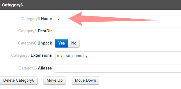

This is how it looks in NZBGet
All download will goto in to “D:\ServerFolders\UseNet-Complete”
Make ure you make a Category named “tv”
In Sonarr the NZBget setting will look like this, see the Category name must be the same.
