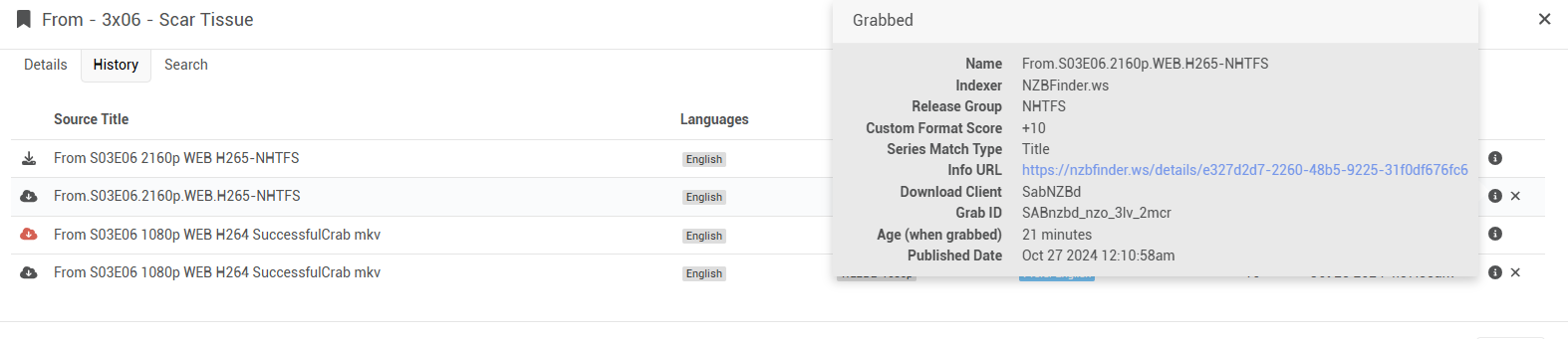

I honestly do not know what to think. Just created the below and for the equalized I’m within range. Tested with tracker and over 2 gigs. Added successfulcrab to the below, tested tracker again and still got over 2 gigs.

Without logs there’s not a lot to tell. Is your indexer reporting incorrect release sizes?
