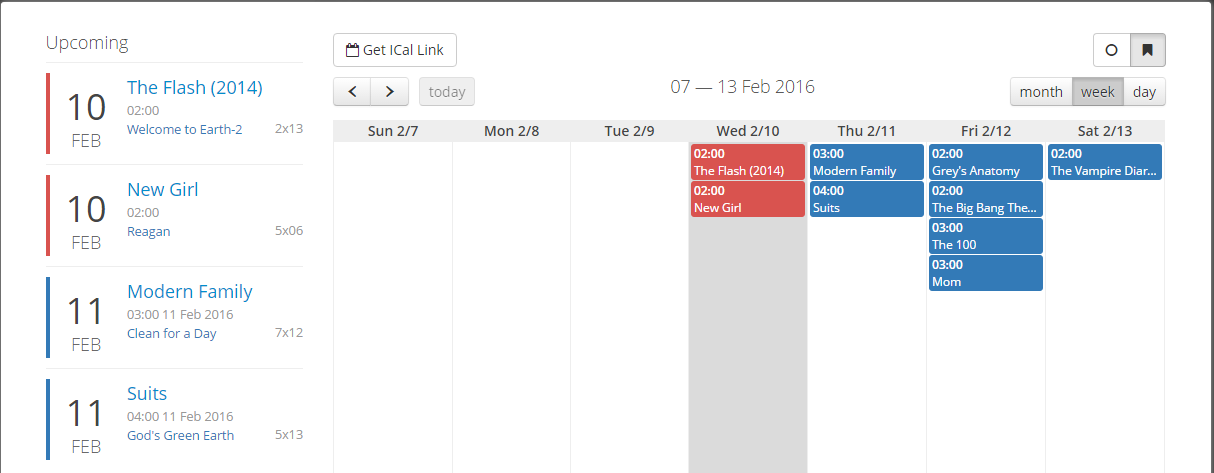

Hello guys,
I recently installed Sonarr on my server HP with debian wheezy (openmediavault) and it’s working pretty fine.
The only problem that I have is episodes are not downloading automatically. I can see they are in “red” color on my calendar tagged as "missing"
I can see its on the “wanted” tab too but the download does not start!
Exemple (Paris Time):
We are on Wednesday 10/02/2016 10h15 am. “The Flash” came out today at 02h00 am.
What can I do?
Thanks

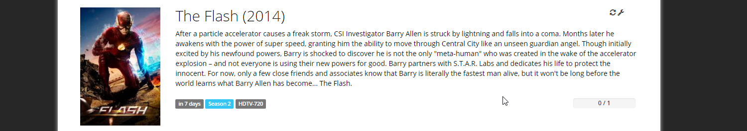

On the tv show page are the episodes marked as monitor ?
Also if you hover the mouse on the exclamation mark on the status column what does it say ?
Of course @great
On the show page and on season view are you episode status as monitored on the left ribbon ?
http://imgur.com/3PleKJY
This is as far as my knowledge of sonarr depth goes :smile:
Yes they are.
let’s wait for some other guy who can help then…
