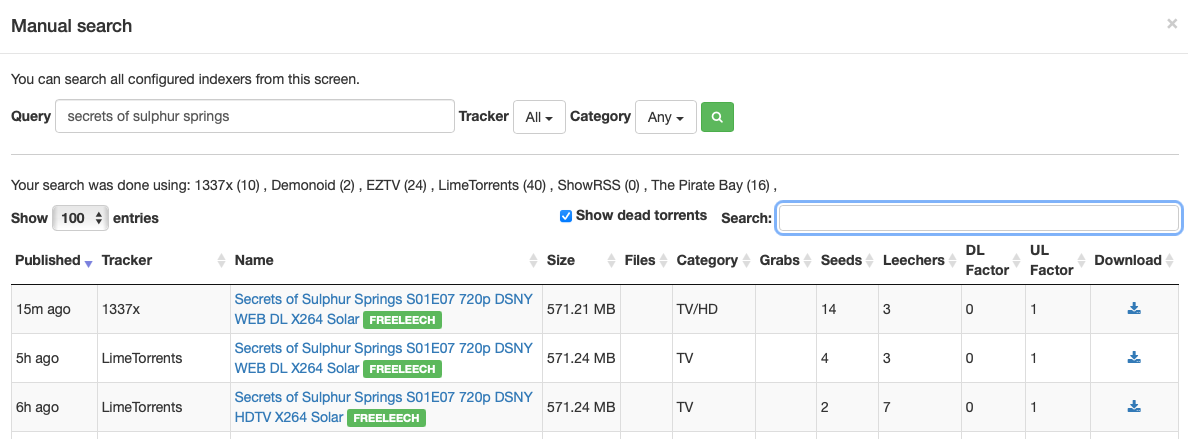

I’m running Sonarr on my Synology, and just about everything seems set up correctly, but downloads don’t start automatically. I have it connected successfully to several torznab indexers from jackett, but scheduled searches never result in a download starting. If I search manually, the show I’m expecting to see does show up, and it will download and process successfully if I do that. The thing I’m expecting to see is the latest episode of Jeopardy, which, according to Jackett and TPB, was available six hours ago (it downloaded after I did a manual search at 20:16).

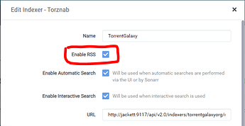

manual searches ask the indexer for everything matching that series id, an automated search only checks the RSS feeds it collects - so make sure you have that option enabled for the indexers you want sonarr to automatically download from. (yes, you can turn them off)

I’m monitoring a few series, but sonarr is not doing anything with them. I don’t expect some of them to show up, since they’re not airing new episodes at the moment. Jeopardy is a good test, since it’s daily.
The timestamp you quoted was 12:28 a.m., so it makes sense that it’s rejecting that one because I previously downloaded it after a manual search at 8:16 p.m. The problem is that it had been available in the trackers for many hours at that point and it never downloaded.

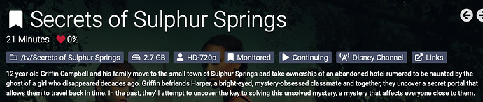

I’m also monitoring Secrets of Sulphur Springs and I can see that the latest episode is available now (and has been for several hours), but it hasn’t downloaded. Here are updated logs (I’ll also switch to trace logging so I can post them if nothing in this one helps): https://gofile.io/d/hCIXOR
You can see it refreshed it at 9:53 and nothing happened even though it is monitored and available (1337x wasn’t added as an indexer in Sonarr at the time, but LimeTorrents was).

settings > indexers
enable advanced options
rss sync interval - think about lowering the sync time down (what is it set to now?) so you dont get gaps (presuming it wont cause you issues with those indexers, they may have feed limits)

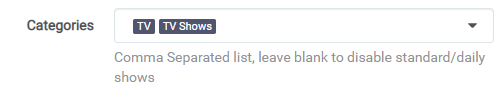

limit the categories (if you arent already) to only the ones you need
if you need more categories then theres nothing stopping you from creating multiple entries for the same indexer, with different categories in each one

Thanks, this is helpful. One last question — is there usually a good way to knowing what category a TV show is listed in. I notice some trackers have multiple things listed as “TV”, usually some much larger number than the standard ones. Can I inspect an episode I’ve downloaded it to see how it was listed? That would help me limit it quite a bit. If they they list the category numbers on their pages, I’m not spotting it. Thanks!
I’ve been checking the feeds manually, and it just seems like Jeopardy is never appearing in them when Sonarr checks.
I checked out the sites where it shows up in searches, and figured out which category they post it in. I put them in the cat query parameter in the Jackett RSS searches, and they actually worked. Now, I did this after the latest episode was posted, so I haven’t had a chance to let Sonarr find it on its own yet, but a manual RSS sync did start the download. Hopefully tomorrow’s episode will happen automatically.
