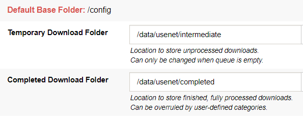

In Sab, under folders, I have as shown in screen shot in above post. which is:
sab should not be putting completed files under a sonarr root path (which /data/media/tv is), it should leave them in a folder that is under the download path instead.
change the path for the tv category from /data/media/tv to just tv - sab will then put completed files in /data/usenet/completed/tv and sonarr will pick them up from there and move them to their final path

it does apply due to you as you have sab configured to move completed files into a sonarr root folder
the trash guide doesnt go into the category config for sab but thats where this issue is coming from. you have it set to move completed downloads to a sonarr root folder, which is why sonarr is complaining.
sonarr will move the files to their correct location so theres no reason for sab to try and do that as well which is why you have sab just put any completed jobs for sonarr under your download path.
