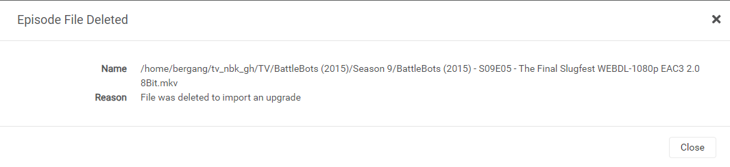

I clicked on the delete icon in the history for the series that is currently doing this and it thinks that as you suggested, it is upgrading the episode.

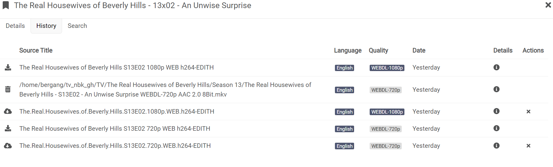

Do you know how that code works when you group two quality labels like WEBRip and WEBDL into one group? My assumption was that in a case like that, either one should satisfy the quality requirement otherwise if they still had precedence within the group there is no advantage to using a group. I wonder if the code is bugged when “Rip” or “DL” is not declared on the NZB itself. Inside the “WEB 1080p” group DL has a higher priority in the stack than Rip and the downloaded file is WEBDL (I include it in the filename output in the Media Management Profile). Whatever is occurring is not consistent as last night it downloaded from the same group who only declare “WEB” on their NZBs but stopped once the quality profile was met (i.e. it originally downloaded a 720p version and then upgraded to 1080p and stopped)…

what does a battlebots episode history look like for one that keeps updating?
Here is the history. You can see it only ever downloads the same NZB over and over without starting at 720p (I turned off monitoring to get it to stop). The first grab of the NZB it was on the NZBGeek indexer for 13 minutes and it was then grabbed the second time from the same indexer 15 minutes later. The third grab was from NZBPlanet who had it for 9 minutes at that time. It continued pulling sometimes from NZBGeek and sometimes from NZBPlanet until I intervened.
