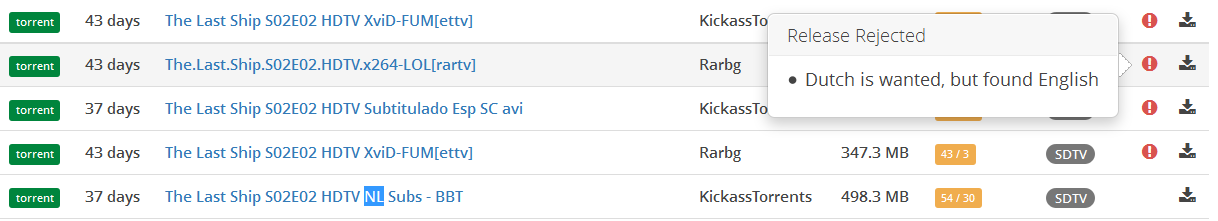

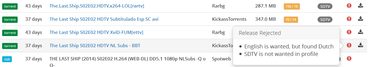

Sonarr doesn’t support multi-language at this time. A show can only be set to either English or another language. If you select another language, English releases will be rejected. And that is a shame for us multi-lingual people
Set to English:
Set to Dutch:
