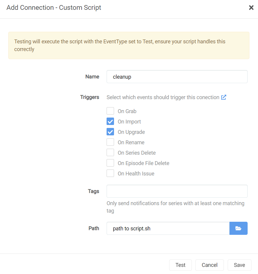

  • My question is how can I get Sonarr to automatically delete the files from the “downloaded” folder after it copies them?
Atm there’s no built in feature for that. Sonarr assumes Remote Path Mappings are actually mounts, and thus applies the ‘this torrent is seeding, i can’t delete it’ logic. But I’m planning to add a switch to Remote Path Mapping at one point that allows you to tell Sonarr that it’s actually a copy, rather than a mount.
In the meantime, using a Custom Script is probably the easiest approach since import events should contain the original file location.
^ This is an example of a post import cleanup script for packed torrents. You can use it as an example, basically you’d just gut all the protections and have it remove everything.
A switch would be awesome for my situation :smiley: , thanks for taking it into consideration.
Thanks for that, much appreciated.
