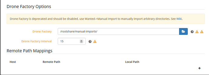

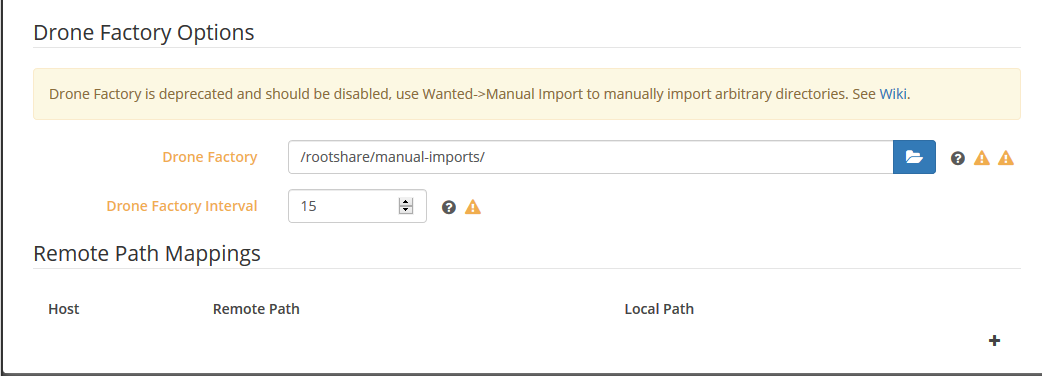

This was done both by a drone-factory folder and letting Sonarr grab the file from the download client.
