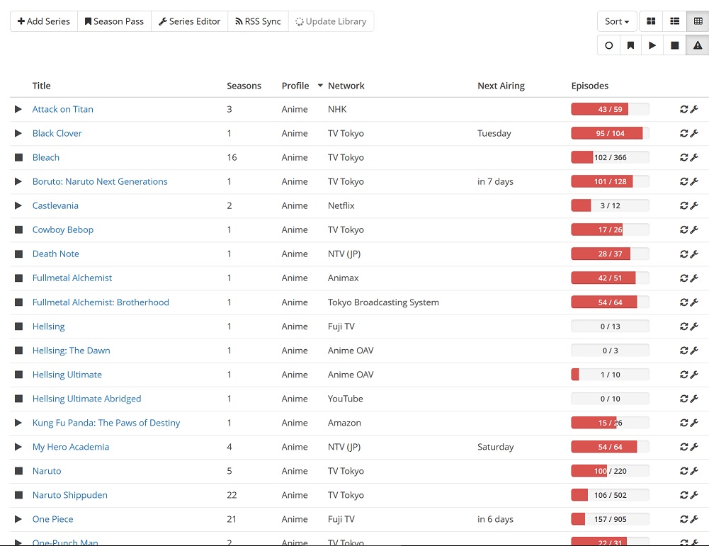

Actually scratch that, it shows that I am missing like at least 10% of each show while almost all of them should be 100% (except for Hellsing, Kung Fu Panda shows).
Up to where Hellsing start they should all be complete, and from My Hero Academia onward they should also be complete, I really don’t get why it doesn’t recognize them even though they are in the same folder as the other items and use the same naming convention.

Your files are named in a way ambiguous to whether they are absolute episode numbers or 3 digit numbers that combine the season + episode numbers so any file labeled 101 or higher will have issues.
Sonarr v3 will improve this in some cases (and probably your case), but typically Sonarr will only match absolute episode numbers when the file name begins or ends with the release group in square brackets.

But basically putting Horriblesubs between square brackets would fix it?
Would it have to be outside of the other brackets or wouldn’t that matter?
Also im on Sonarr 2.0.0 so I guess version 3 will still take some time to be released?
Outside.
It’s in beta, no ETA for replacing v2 at this time.
Okay thanks for the information. Might try renaming them in the meantime when I have some spare time.
Just did a few and works like a charm, picks them up right away =)

The files are named in a way that Sonarr doesn’t parse them as anime (they’re too ambiguous to be sure).

It’s using the S01E01 as the season + episode number, ignoring everything else.
Everything converts back to a season + episode, so that’s what needs to be selected.
The row was checked and everything was selected (series, season, episode, quality and language)?
So it sees part of the title as the season/episode number due to the dash? That’s unfortunate, but then i’ll simply remove the dashes if I see them pop up in titles. I’ll try it in a minute and see if that fixes things.
Edit: okay it’s not the dashes, apparently something else in the title confuses it to link to the wrong season/episode :frowning:
Edit2: It’s the numbers in the episode title name (part 1, part 2, 100 million, anything like that). Apparently instead of taking the first number it takes the other one in the title? :face_with_raised_eyebrow:
Yes, and the funny thing is it only happened for that show (Bleach I believe). Tried doing the manual thing with 2 others in the meantime and was able to import those “missing” files just fine.
Edit: tried again and it worked (this time by only showing unmapped items), so I guess I must have missed something in the big list :slight_smile: my mistake
Is there any way around this naming issue? Many episodes have a part 2, 3, 4 etc. So this issue would occur on a regular basis.
The only way to deal with that is to have better file names. Absolute episode numbers are often ambiguous with other numbers, the best way to deal with that is to use a standard anime release name (release group at the beginning or end in square brackets).
The alternative is to use standard episode numbers (S01E01) instead of or in addition to the absolute episode numbers to take away the ambiguity.
