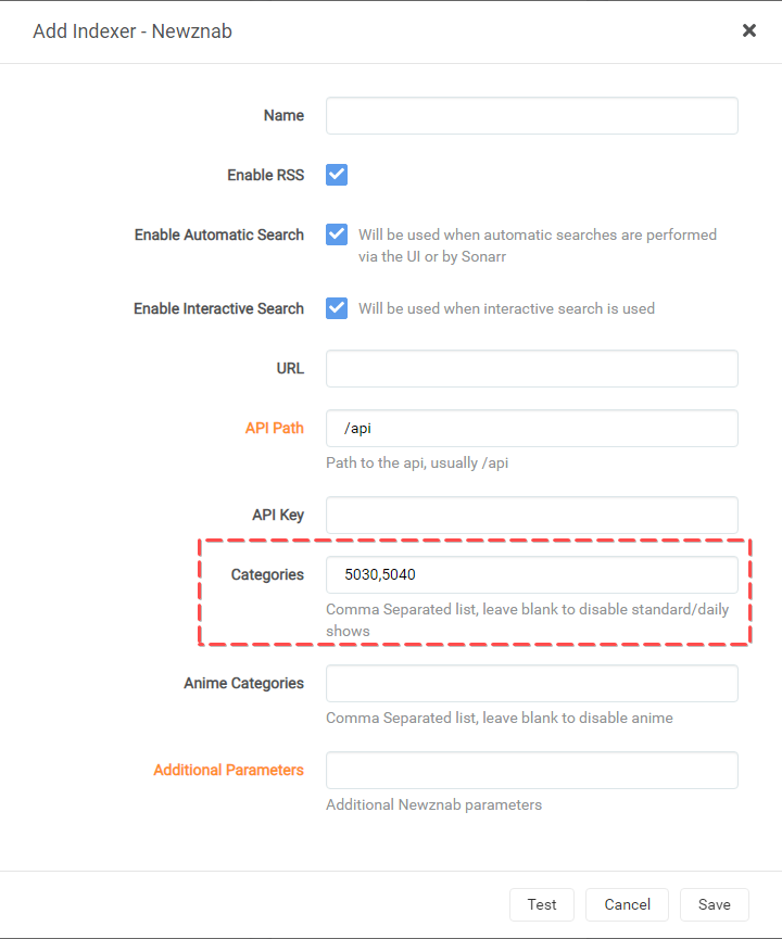

If results are in a different category that you haven’t told Sonarr to request then you won’t get results from that category… HEVC often has it’s own category on the indexer, you need to tell Sonarr to include it.
when you say categories do you mean the quality and profiles tabs because I don’t see anything that even resembles HEVC maybe i’m missing something obvious
No, I mean the categories for the indexer.
ah I see now I got to figure out which category covers hevc
Got it all figured out thanks so much
