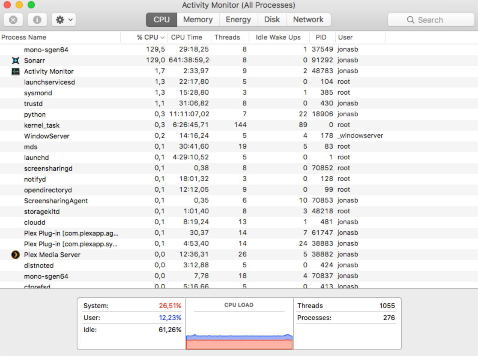

Ok, this is what my Activity Monitor looks like after the restart with trace-level enabled:
Ok, I tired of waiting and tried to kill all mono-processes (after a shutdown from the webgui).
Started again, and now the CPU is back to “normal” (below 10%).
