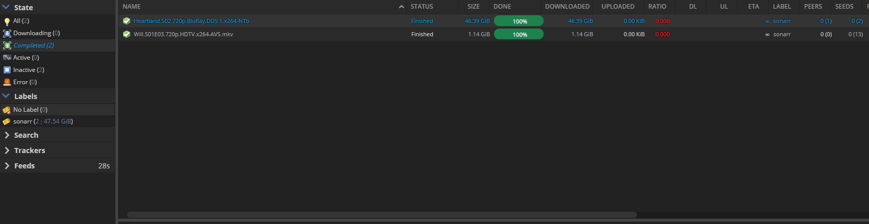

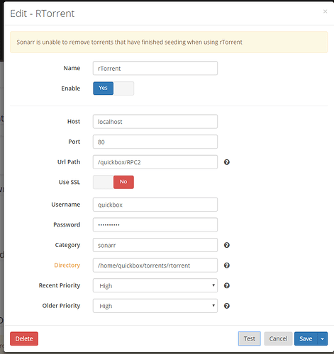

Can you post a screenshot of your rtorrent settings and the torrents (with labels) in rtorrent?
Which rtorrent settings would you like? Lots of tabs there. Note: I also tried having no category in sonarr
The category is required otherwise Sonarr will only ever track things it added.
Going to add some more logging in the next release, but for the moment can you double check the category in Sonarr doesn’t have any spaces at the end?
If the category is fine (it looks fine as far as I can see) we’ll have to wait for the additional logging to see if it’s being rejected for another reason.
