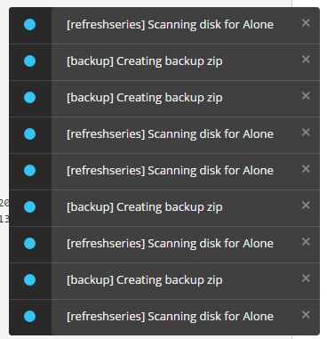

Up until yesterday, Sonarr had been running fine. No updates or changes have been made in a number of days. Beginning yesterday, while looking at the web interface and while monitoring my processes, I noticed that the RSS Sync task was running every 30 seconds (configured to run every 10 minutes) with the notification toasts stacking up (10 “RSS Sync service started” toasts were stacked).

The Gist URL above is a trace log which ran for a minute after restarting Sonarr. This is a screenshot of the toasts during the same time: https://i.gyazo.com/7eca15782dc083ad07975162d32b7f87.png

Sonarr can only run 3 tasks concurrently, this looks more like a display problem than the jobs running concurrently, they may be getting stuck because Sonarr never sees a completed update for them, The trace logs don’t show multiple of the same tasks running at the same time.
Thanks for the reply! I don’t believe there is anything preventing Sonarr from writing to it’s database and I’ve confirmed the file permissions are correct. I believe you’re correct about the “stacking” of tasks being a display issue as I’ve done a bit more digging and found a few more details that I hope can help:
