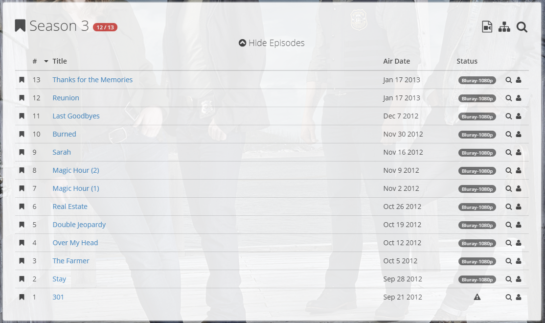

I downloaded full seasons of Haven and all the files are there and working on my disk. Sonarr was able to see every episode except for Ep.1 of Season 3, which is titled “301”. I cannot for the life of me figure out why this one episode is not being detected by Sonarr. I wish there was a way to map exactly where the file was instead of only being able to scan the disk. All of the episodes are named in the same format so that’s not the issue. I really can’t figure this out, if anyone has any ideas on what to try I would greatly appreciate it. I’ve attached a screenshot of both the Sonarr and the folder on my disk drive. I would attach debug files but it simply scans disk and says completed in the bottom right corner so I don’t think that would be helpful. If necessary I will figure out how to do that and post it.
Some additional information: I tried renaming the file title “301” to something else just to see if that was the problem but it still didn’t pick it up.
Thank you.
Based on the file names the 301 along with the info in square brackets, would trigger anime parsing. You can use Manual Import (on Wanted: Missing) to import the file though, just point it at the season folder.
OMG Thank you! this worked. I didn’t know where to navigate for that. This is exactly what I needed. Everything is working now :smile:
