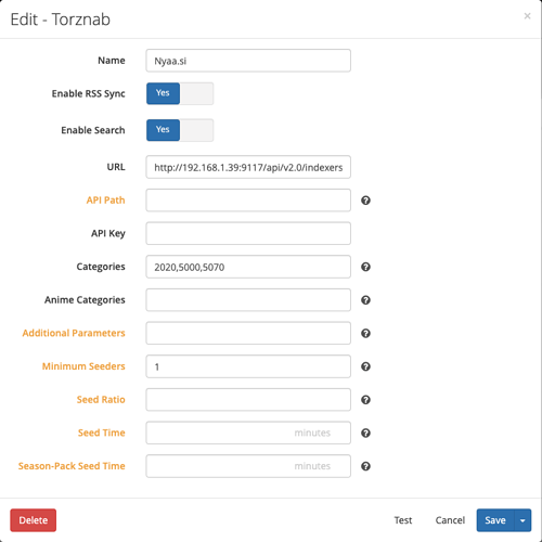

Have you specified anime categories on those indexers?
I believe so, here are some screenshots. The categories were a little confusing at first, but i’m pretty sure these look correct:
26%20PM
2 of the screenshots are from jackett UI, and the other 3 are from sonarr UI.

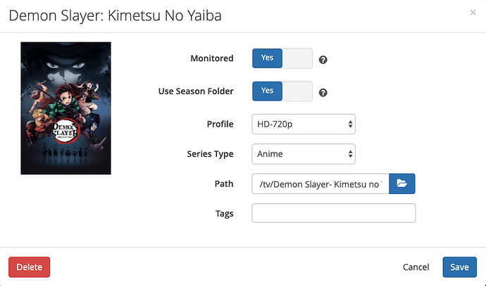

Anime categories are empty in both your indexers in Sonarr. If they’re empty nothing will be searched for when the series type is anime.
THANK YOU SO MUCH! That fixed it!
I didn’t realize the categories for anime (like 5070) had to be separated. I figured that option was to specify different anime “types” (ex: Shonen, etc.) I couldn’t find anything in the docs about the “anime category” feature, and I’d like to read about it some more. Any links would be much appreciated. Thanks again!
