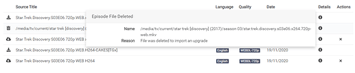

could you also open say vikings s06e01 and check the actual history tab of that, it should show all the activity for that particular episode. if there is a trash icon (deleted) in there then check what the info icon says

As suggested, here is the screenshot of an episode that was mass deleted.

according to that sonarr didnt delete the file, it just noticed it was missing from disk and removed it from the database. and its done it at least twice so far
even if you had the delete empty folders option enabled it wouldnt be able to do that as the path isnt available. ie if it cant scan because it isnt there then i dont see how it could delete
sonarr actually deleting the episode looks like this
theres also no grab or import actions in the history so it looks like sonarr is just keeping track of what turns up in the folders?
