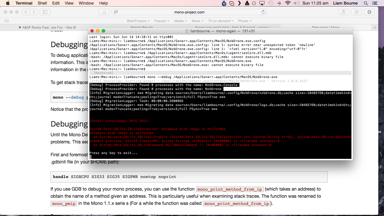

You need to run Sonarr through mono:
mono --debug /path/toNzbDrone.exe where /path/to is the full path to NzbDrone.exe

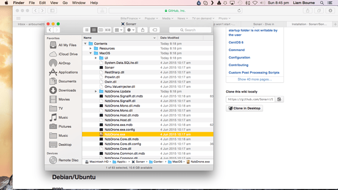

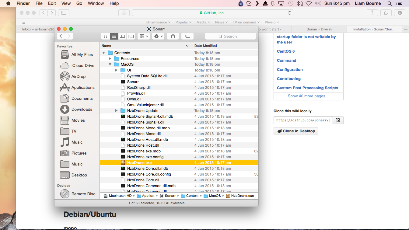

Hi Markus,

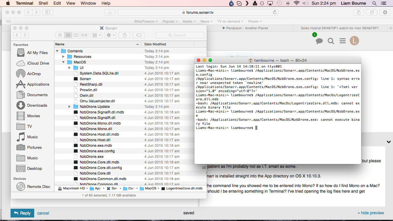

Thanks for helping me out with this as Iām desperate to get sonarr up and running again but please be patient as Iām probably not as I.T. smart as some.
Sonarr is installed straight into the App directory on OS X 10.10.3.
Should I be entering some command line in Terminal? Iāve tried some pathways here and attached for you to see. Or should I be doing something in mono (which Iāve never seen or used).
By the way canāt afford the fresh HD wipe.
Use the path you used (to NzbDrone.exe) in the terminal after mono --debug. Or just delete the existing app and redownload Sonarr and start it up the same way you did before, the settings are stored elsewhere.

Yeah, the config file and database are stored outside of the install directory, on OS X that is:
/Users/<user>/.config/NzbDrone/ (replace <user> with the user running Sonarr).
Easiest way is to restore a database backup: https://github.com/Sonarr/Sonarr/wiki/Backup-and-Restore
