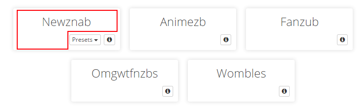

Where do you see a place to setup NZBMegasearch at from the indexer page as I don’t have that listed anywhere?
i added it myself with + icon
There is a + icon under the Settings / Indexers page but there is no where in there to setup a custom Indexer that remotely correlates to NZBMegasearch. I don’t think you can just pick one of the predefined defaults and switch the information around in it to suite your needs. The indexers are custom.
Click Newznab, don’t pick on of the defaults. You could pick a default and change all the settings, but there is no reason to.
derp…
thanks I’ll give it a shot.
