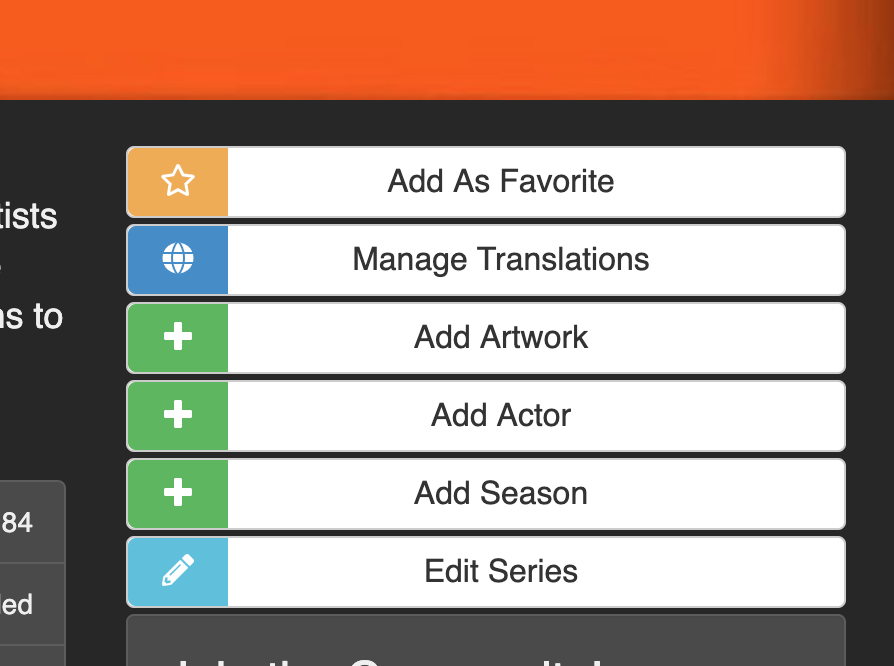

https://www.thetvdb.com/series/behind-the-music-remastered
You’d add the changes to the TheTVDB as there isn’t much Sonarr would do if the theTVDB isn’t updated.
