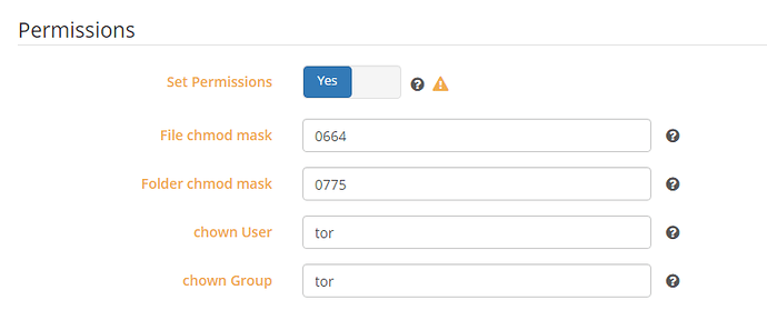

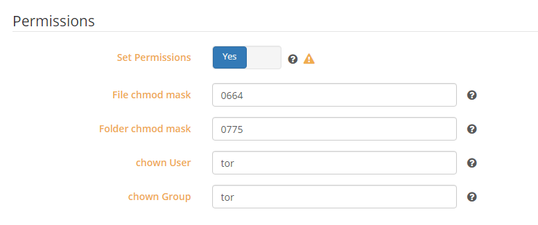

And I updated Sonarr and Radarr to adjust the permissions using the web gui
However, when I upload a file through ruTorrent (which runs on apache) it is still not adding write permissions to the group. The files in question are simply the .torrent files that get sent to ruTorrent to being the transfer.
