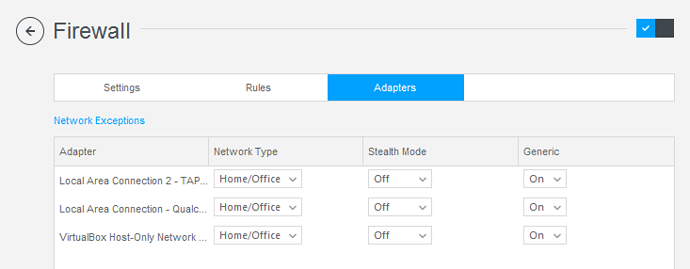

Removed previous and tedious workaround. Spoke with Bitdefender support, and they advised the following changes need to be made.
Go to the Adapters tab > at “Network Type” select “Home/Office” > at “Stealth Mode” select “Off” > at “Generic” select “On”
Now please go back (click on the “back” arrow in the upper left part of the window ) > Intrusions Detection > turn off Intrusion Detection System (I didn’t do this part)
