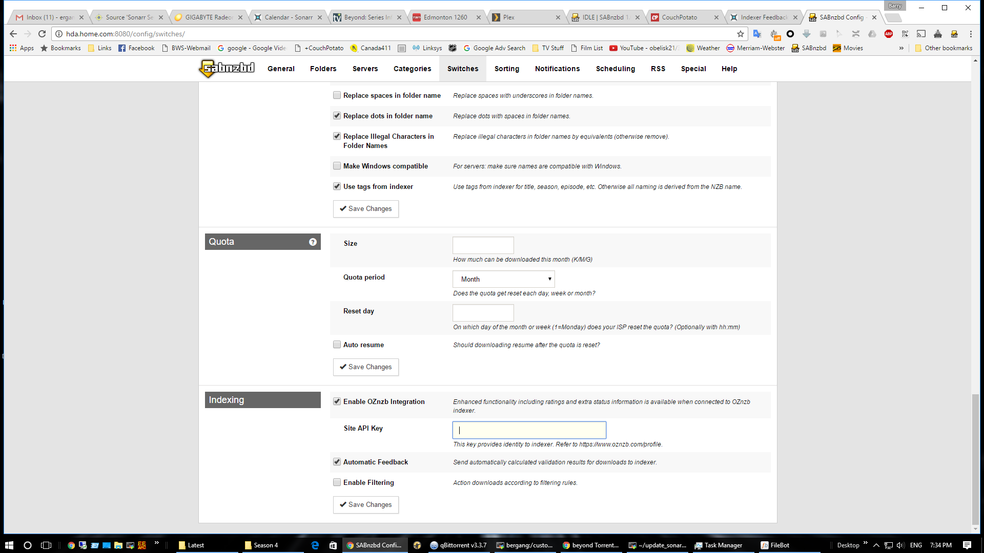

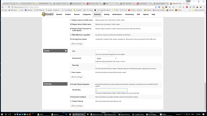

I have that feature active in SABnzbd and it is providing feedback to OZnzb automatically. As Markus indicated Sonarr isn’t actually downloading anything (including the NZB itself) so it makes more sense for the downloader to handle the feedback to OZnzb.

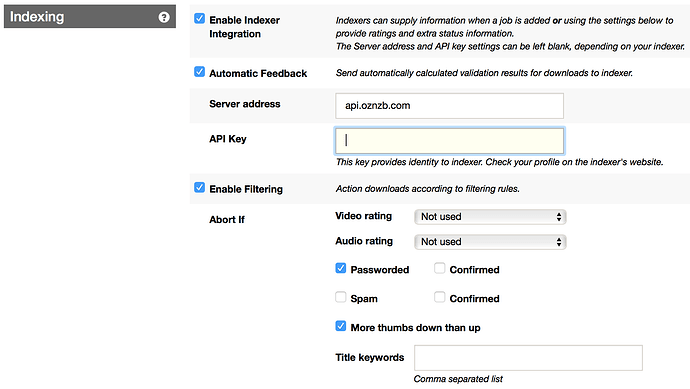

If you are using SABnzbd you can see in the image below the configuration section called “Indexing” which has the OZnzbd integration.
