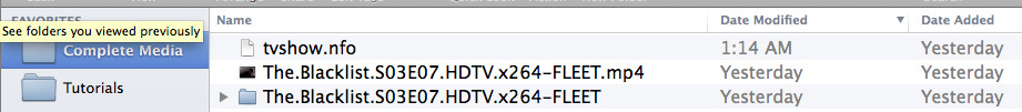

No logs for the file in this example, which can be seen in my completed folder here:

15-11-13 15:50:20.4|Debug|DownloadedEpisodesImportService|The.Blacklist.S03E07.HDTV.x264-FLEET folder quality: SDTV v1
15-11-13 15:50:20.4|Debug|DiskScanService|Scanning '/Volumes/Media1/Complete Media/The.Blacklist.S03E07.HDTV.x264-FLEET' for video files
15-11-13 15:50:20.4|Debug|DiskScanService|0 video files were found in /Volumes/Media1/Complete Media/The.Blacklist.S03E07.HDTV.x264-FLEET
15-11-13 15:50:20.4|Debug|ImportDecisionMaker|Analyzing 0/0 files.
And this episode is not in queue, but the original rar folder for it is in the queue, with an error that says:
No files found are eligible for import in /Volumes/Media1/Complete Media/The.Blacklist.S03E07.HDTV.x264-FLEET
Could this whole issue be due to these episodes being decompressed rars?
Yeah, you need to have the video file extracted into the folder that uTorrent is reporting:
/Volumes/Media1/Complete Media/The.Blacklist.S03E07.HDTV.x264-FLEET/The.Blacklist.S03E07.HDTV.x264-FLEET.mp4 instead of /Volumes/Media1/Complete Media/The.Blacklist.S03E07.HDTV.x264-FLEET.mp4 so Sonarr sees the video file to import.
