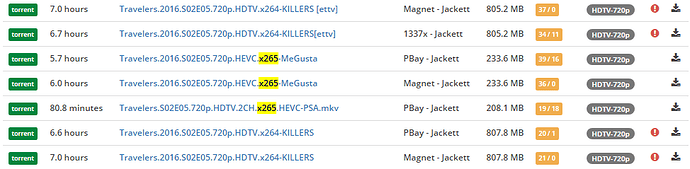

I actually found a similar case with Travelers S02E05 also looking for x265. If I do a manual search i see 3 options:
Indexer 1: 5.7h and 80m ago
Indexer:2: 6h ago
–> I have the screenshot if needed.

Ok got into my docker instance and grabbed all the logs. Found this below related with the issue with the Travelers Series:

17-11-14 18:25:05.0|Debug|DownloadDecisionMaker|Release rejected for the following reasons: [Permanent] Not enough seeders: 0. Minimum seeders: 1
This is 3:25pm EST and I have the manual search screenshot taken at 3:18pm EST where it shows me the following.
Obviously this is not consistent with what the indexer is showing also the other release from “MeGusta” is not listed.
What could be the reason of the discrepancy?

Ok, got it but if the RSS sync is running every 15m why after 80m that the release has been posted is not updating the seed count. Is it 80m normal? Is is anything that could be done to show “live” data?

That’s exactly what i don’t get. My screenshot is showing at that time what is the seed count in the indexer (s=19 - l=18) but Sonarr is showing s=0. This means, according with my understanding of how Sonarr works (that could be wrong :slight_smile: ), that this was updated in the last 15m or less and that’s why Sonarr didn’t get it (yet)?. I found very unlikely that in the last 15m or less the seed count went from 0 to 19 but I guess it could be the case.
This is also means that in the next RSS sync (next 15m or less) Sonarr would have updated it and grabbed the release.
I guess the timing could be off if something was wrong with that indexer during this period of time. One thing that could reduce this cases would be to add more indexers hoping that this release(s) are available in more than 1. In this case 1 release was not picked up by some reason and the other was not grabbed due to the seed count.
Can you please confirm that my understanding is correct?
That’s very possible, especially when the indexer likely gets peers in intervals, not constantly updating.
If the item is still in the RSS feed, then yes it would get the updated count and process the release again.
