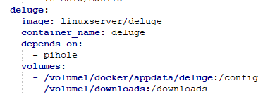

Your docker configuration doesn’t allow for hardlinking because /downloads and /video are different volumes in the container, regardless of them being on the same volume on the host.
If you want hardlinking to work you’d need to map /volume1 to both containers instead.
That makes sense. I remember having to configure my other system the same way as you just recommended.
